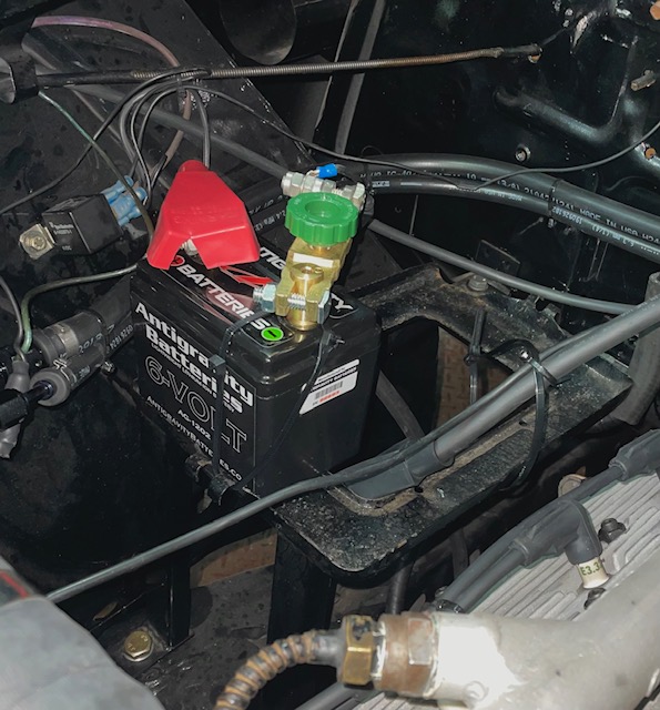

This is probably not that interesting but wanted to mention it. A month ago, batteries on the Comète were dead. It seems turning the ignition off, does not cut off power to everything and there must be a leak somewhere. In my other cars, I always have a hard battery cut-off switch and all goes well. I had not yet installed one on the Comète.
In any case, as a short term measure, I installed this tiny 6V lithium motorcycle battery (I believe the only 6V lithium vehicle battery made). So far so good! It starts the engine without a problem, seems to charge well (I think it has protection circuits inside). Best part — it weighs half a kilo.

aelam@nyc.rr.com a écrit : ↑ven. juin 16, 2023 6:48 am This is probably not that interesting but wanted to mention it. A month ago, batteries on the Comète were dead. It seems turning the ignition off, does not cut off power to everything and there must be a leak somewhere. In my other cars, I always have a hard battery cut-off switch and all goes well. I had not yet installed one on the Comète.
Ce n’est probablement pas très intéressant, mais je voulais le mentionner. Il y a un mois, les batteries de la Comète étaient mortes. Il semble que couper le contact, ne coupe pas l’alimentation partout et il doit y avoir une fuite quelque part. Dans mes autres voitures, j’ai toujours un coupe batterie et tout se passe bien. Je n’en avais pas encore installé sur la Comète.
En tout cas, à court terme, j’ai installé cette minuscule batterie de moto au lithium 6V (je crois que c’est la seule batterie de véhicule au lithium 6V fabriquée). Pour l’instant ça va! Elle démarre le moteur sans problème, semble bien charger (je pense qu’il a des circuits de protection à l’intérieur). La meilleure: il pèse un demi-kilo.

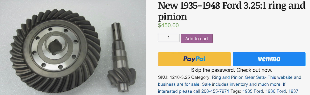

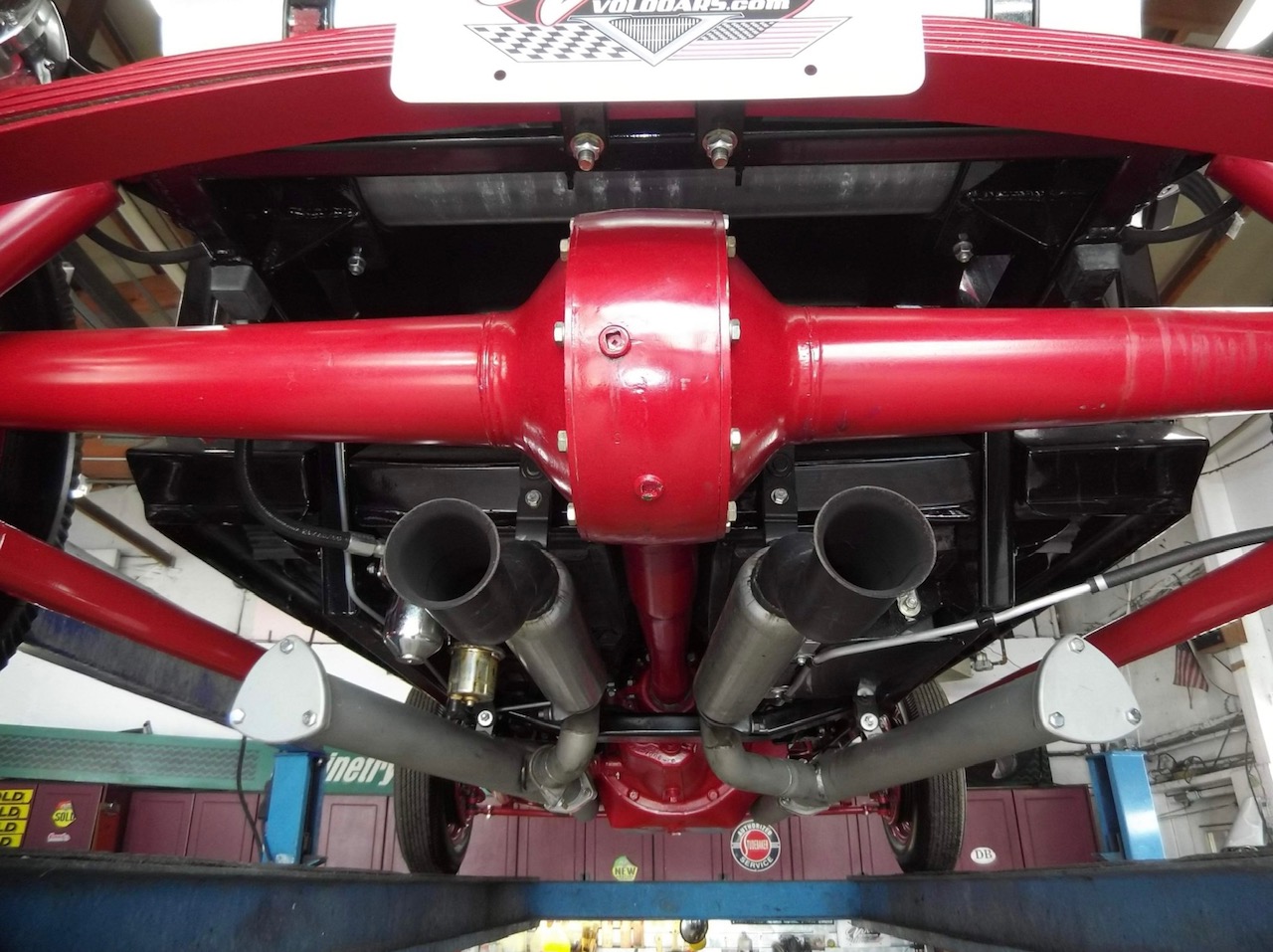

Hi, I noticed that the rear axles on the Comètes, Vedettes, Vendômes look identical to ones on US Fords of the 40s. If that is the case, I can change the rearend ratio simply with this:
https://hotrodworks.com/product/new-193 ... nd-pinion/
Do uou think it would work?

Many French Ford parts are similar to US Ford parts, but there might be some slight changes.
The only way to be sure would be to disassemble your Comète rear axle and compare it to the US one.

So, we bought this. Not crazy expensive. I will report how it works out.
Re: Une nouvelle Comète au US
Thanks to let us know, I'm curious to hear about it!
It will be great if this could work... keep us posted.
