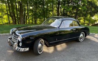

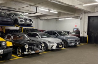

This is my 1953 Comète. I bought it in 2019 in Clermont-Ferrand. Immediately afterwards, I and my two sons, drove it to Madrid where I have a home and garage. This was an extremely arduous trip, especially crossing the Pyrénées, in second gear, with the engine heating up…don’t ask!
Then Covid intervened. I finally shipped it to the US in December 2021.
My immediate concern was the weak engine. It actually turned out that one cylinder had deep scratches and no compression.
As you may know, there are several “after market” parts made for this engine in the 1940s and 50s, for their use in “midget racers.” We installed them all, including double Webber carburetters. The pistons were custom made. Car now has reasonable power, like 87HP on the dyno.
This brings me to my question. With more power, I need a lower differential ratio — car now does 60kmh at 3500 RPM! But I do not even know what brand / maker this axel / differential is?
Any help or suggestions would be much appreciated.

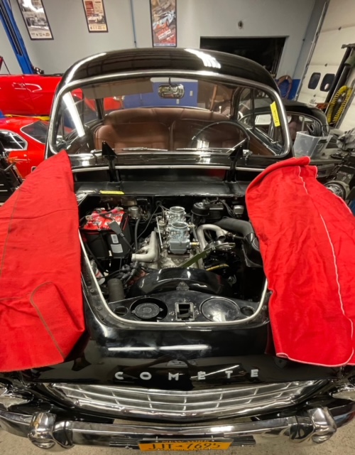

Deux photos de plus:

Hi Ali,
That's a fine car, a nice engine and a nice garage that you have!
I don't really see the point of having a lower rear axle ratio with a more powerful engine.
I believe that your car came with the standard manual 3 speed transmission with third gear ratio is direct drive 1.1.
60 km/h at 3500 rpm is the normal engine rotation speed for this car, but l guess that you are looking for a lower ratio to decrease engine speed rotation and noise, which is understandable.
The rear axle is French Ford made and I believe it is the same as the standard Vedette sedan which is rear axle ratio 4.33.
The solution will be to find a French Ford Vendôme rear axle with a 3.455 ratio but it will be really hard to find!
A cheap and easy way to reduce engine speed rotation would be to choose bigger tires, but it might change the general look of the car...

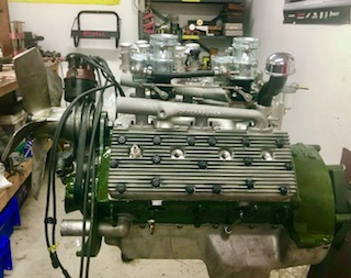

Re: Une nouvelle Comète au US

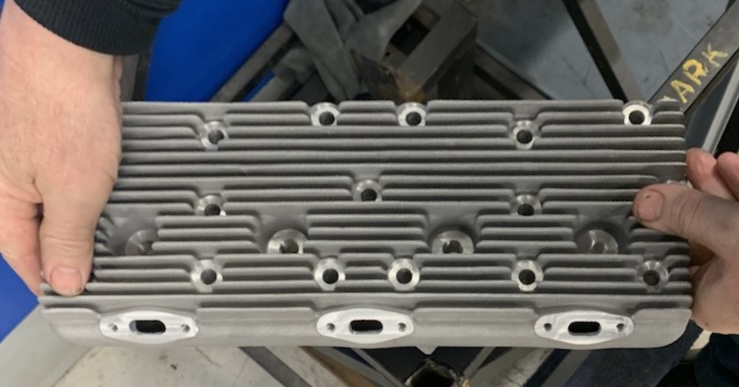

I am not 100% sure what parts the engine shop changed. I will ask and get a list.
I do not think we changed the cam.

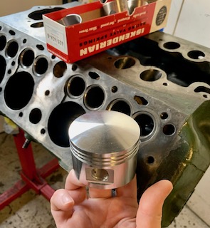

The engine builder said that while he could add a lot more power, the piston rods, which are no thicker than a small finger, would not take it. He said they would need to make custom rods which would take a long time. Here are a few pictures:
- IMG_4510.jpeg (87.86 Kio) Consulté 4409 fois
- IMG_4511.jpeg (111.76 Kio) Consulté 4409 fois
- IMG_4512.jpeg (92.51 Kio) Consulté 4409 fois

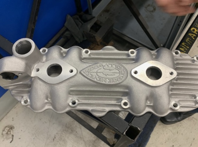

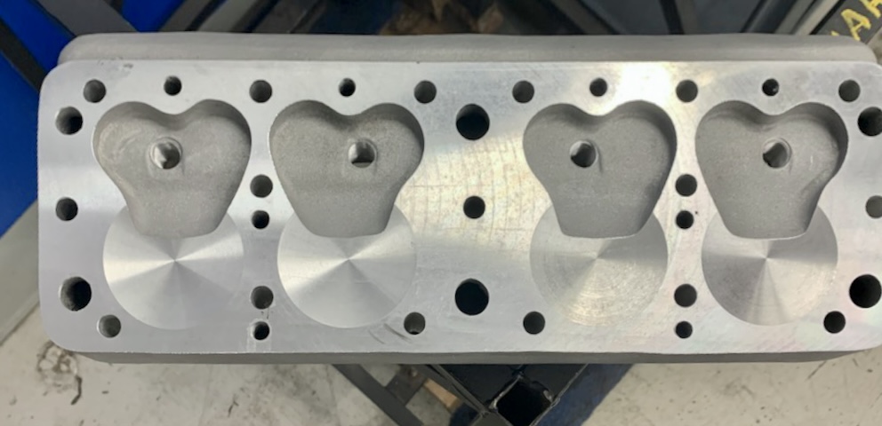

- Messages : 3782
Thanks for the pics Ali, the dual carb intake manifold is Eddie Meyer, but what about the heads?
What carbs are you using which such 2 holes on the manifold?
It can't be the regular Stromberg right?
I was asking the question regarding the camshaft because I noticed that you used Isky valves springs.
“I was asking the question regarding the camshaft because I noticed that you used Isky valves springs.”
— Oh! I think that is just the box where they were holding the custom pistons. Sorry for the confusion.
- Messages : 3782
Ok, I see no worries. I checked with Speedway online shop and I saw that the Eddie Mayer manifold and Offenhauser heads were still available there.
But no performance camshaft or double valve springs you're right!
