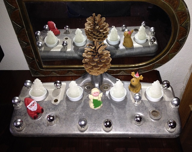

A funny way in recycling V8 cylinder head :hehe:

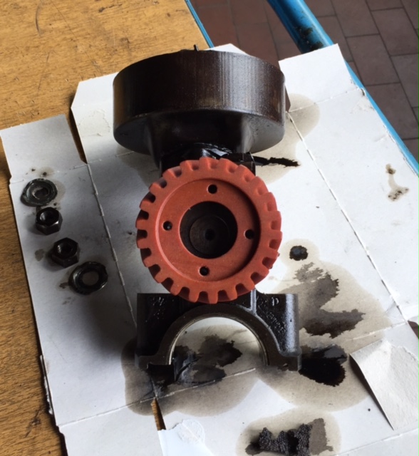

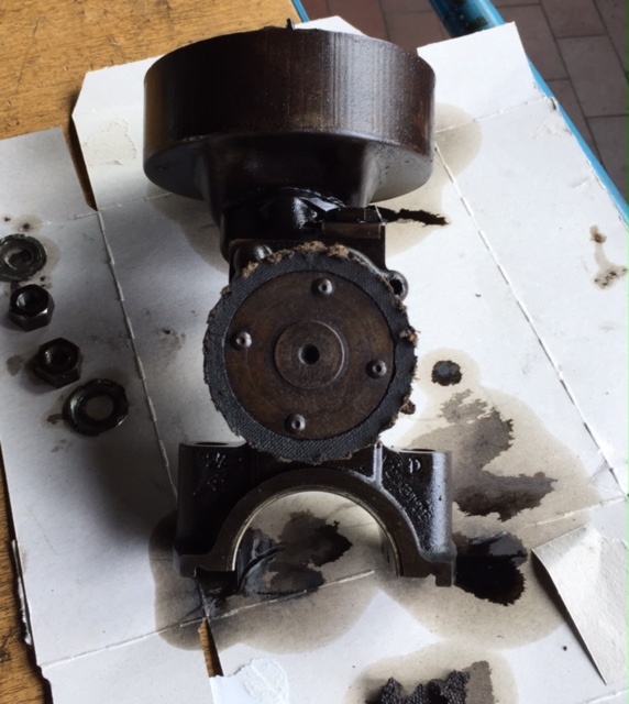

The true reason for the final breakdown...never seen anything like this before!
Zahnrad alt.jpg (119.17 Kio) Consulté 12482 fois
Zahnrad neu.jpg (122.44 Kio) Consulté 12482 fois
I´m not sure, whether its a question of the wrong oil. Anyone any idea?
My personal happy end: LaVerdette ist already running again...
Bruce S. & LaVerdette.jpg (94.13 Kio) Consulté 12482 fois
Re: Une Chambord bavaroise
Hi Michael, it seems that your oil pump pinion has lost all its teeth on the way to the North Sea !!!
Anyway, good to know that your car is running again...
Hard to believe that a wrong type of oil can cause such dammage. Oil pump celoron pinion gets sometimes dammaged with time, even if you are using NOS parts.
Some mechanics recommend to leave the celoron pinion in an oil bath before assembly on the oil pump.
I always wonder why Simca didn't used aluminium pinions instead of celeron...
It seems that you found a good and actual replacement part to solve this issue.

Hi Fred,
Yes! Thank god I stopped LaVerdette right in time before the engine failed!
Luckily the red oil lamp went on, probably because the oil pressure went down?
And luckily I watched the oil lamp in the right moment!
I bought the pignon at techni-tacot.com.
May be not the cheapest one, but still my favorite adress, as they had delivered me all the things I needed for my motor reconditionning in 2014.
Driving the Chambord is great!

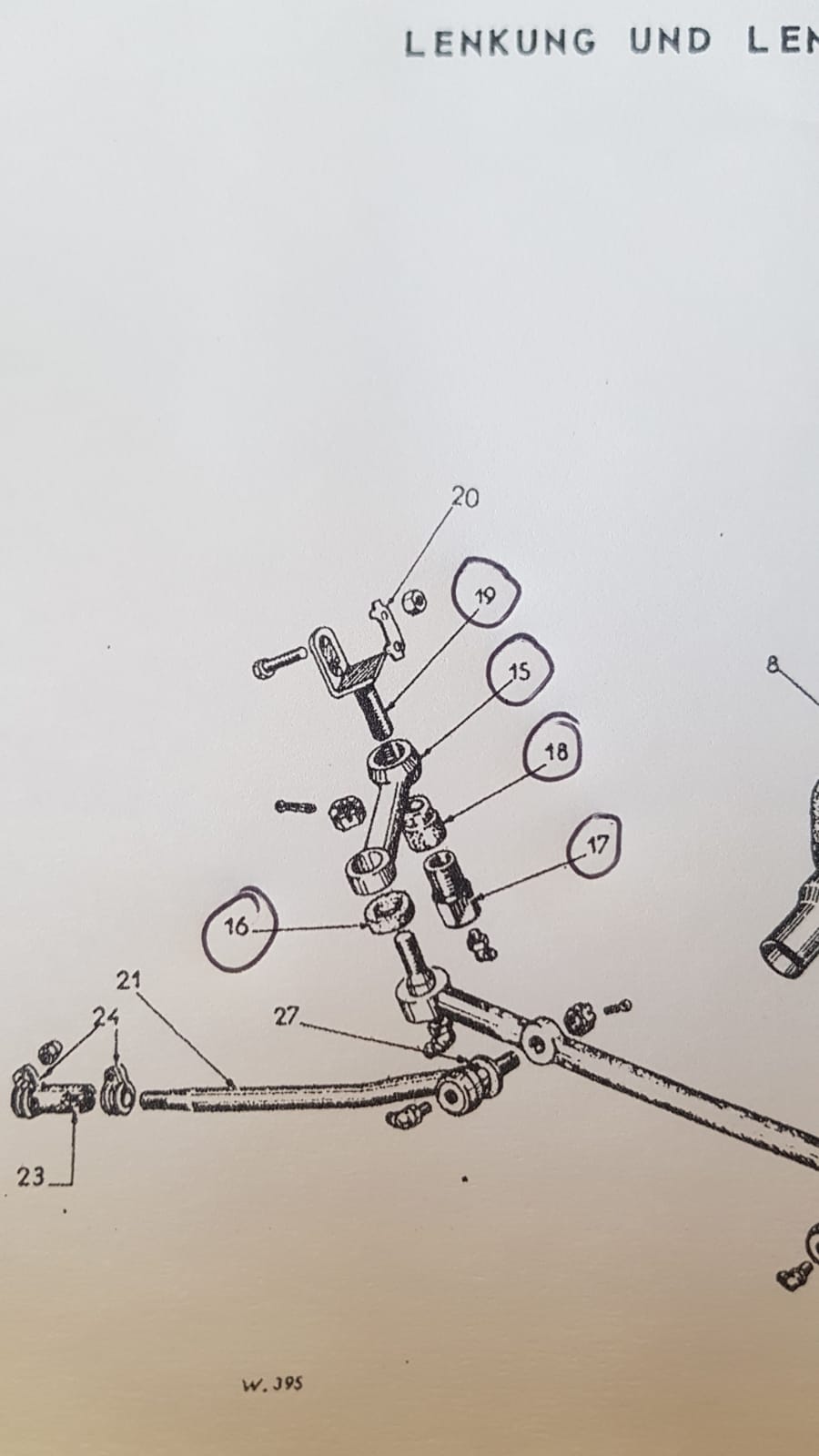

pour ma Simca Chambord de 1958, Châssis No. AB153493, j'ai besoin de la bras pour la transmission comme indiqué sur l'image ci-jointe.
Liste des pièces nécessaires:
51519-V Bras
50059-N joint
64608-l Douille
50050-R joint
64607-B Support
Pouvez-vous fournir ces pièces?
Merci beaucoup
