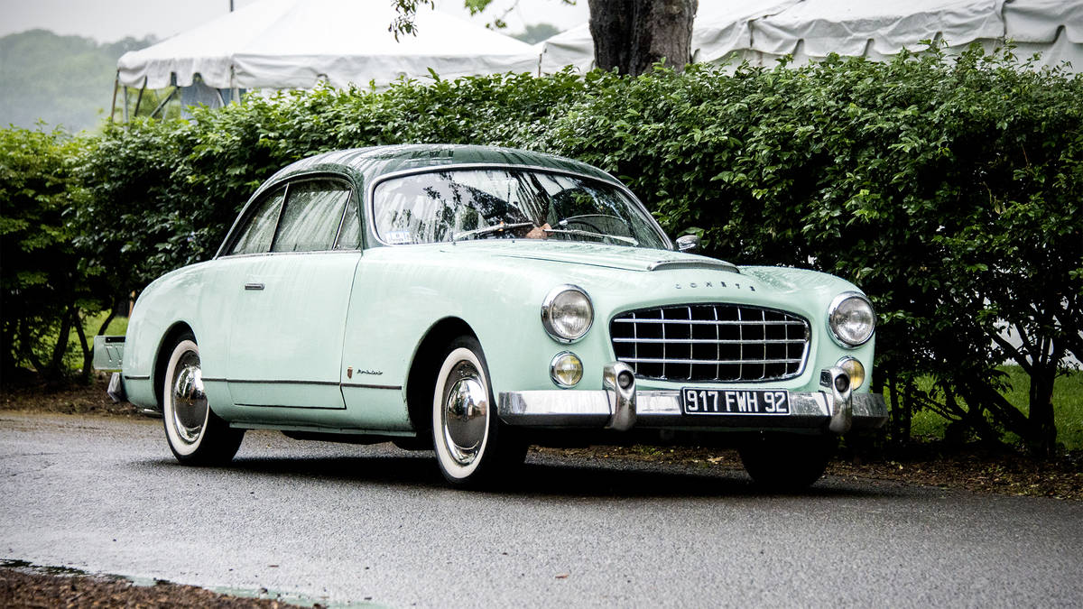

Bonjour, I have an 1954 Comète Monté Carlo. Can someone help me source correct distributor rotor, points and cap? Has anyone installed an Electronic Distributor conversion?

- 1954-ford-comete.jpg (216.83 Kio) Consulté 9740 fois
